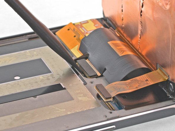

  • Use the flat end of a spudger to pry the digitizer cable connector straight up and out of its socket.
