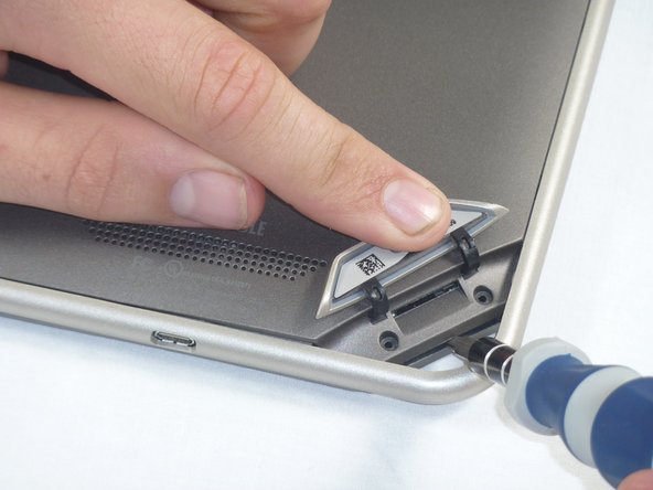

  • Insert the flat end of a spudger between the front panel and the rear assembly.
  • Though these photos show a screwdriver, use a spudger or plastic opening tool in order to prevent damage to the device.
  • Use a spudger to lift the the back panel from the rest of the Nook.
