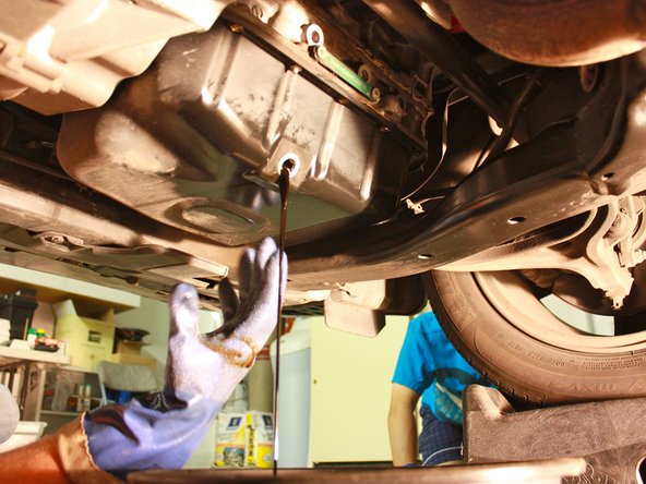

  • Let the oil completely drain into the drip pan.
  • Put a new crush washer on the drain bolt, then reinstall the drain bolt.
  • Using a torque wrench, tighten it to:
  • 33 lbf·ft (45 N·m , 4.6 kgf·m) for 4-cylinder models
  • or 29 lbf·ft (39 N·m , 4.0 kgf·m) for 6-cylinder models.
  • Set the drip pan aside.
