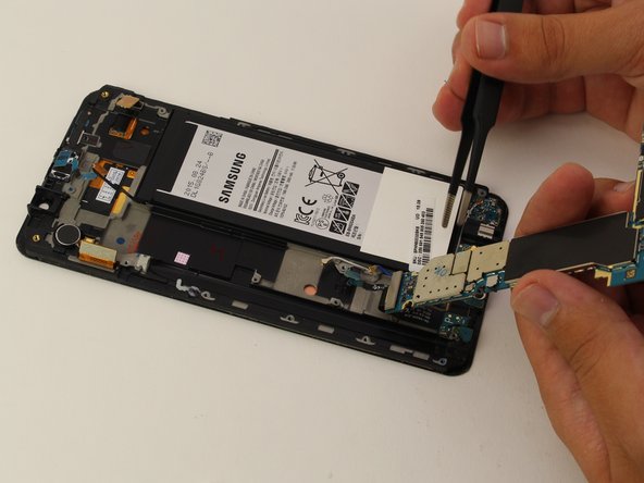

  • Gently lift up the motherboard from the top end to remove.
  • Make sure all flexes are disconnected before removing the motherboard. If the motherboard does not easily detach, remove any connected flexes.
