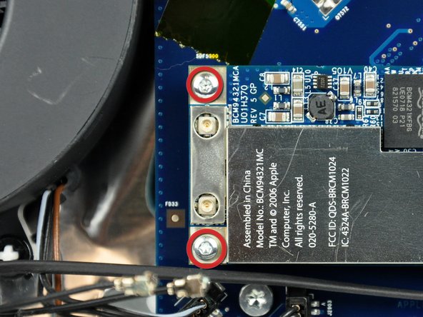

  • Remove the two T6 Torx screws securing the AirPort card to the logic board.
  • At this point, the free end of the AirPort card should pop up slightly.
