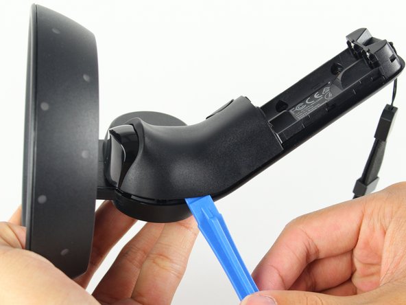

  • Turn your controller 90 degrees clockwise and insert a blue plastic opening tool into the crease of the back panel.
  • Push down on the end of the plastic opening tool closest to you to lift the panel up.
  • Slide the plastic opening tool around the perimeter of the back panel until you can remove it.
  • You may hear loud popping noises as the back panel separates from the controller.
