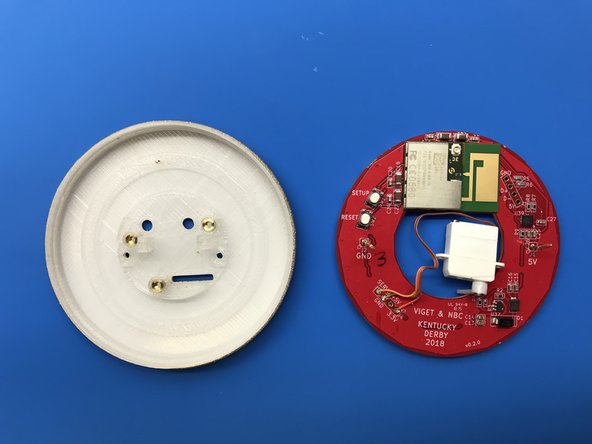

Mount servo
  • Pull the servo through the donut hole of the PCB (top to bottom).
  • Orient the servo arm to the left (aligned with the rest of the body). This represents the zero degree location.
  • Manually move the servo arm down 90 degrees so it is now points downward into the work surface.
  • Mount the servo to the enclosure.
