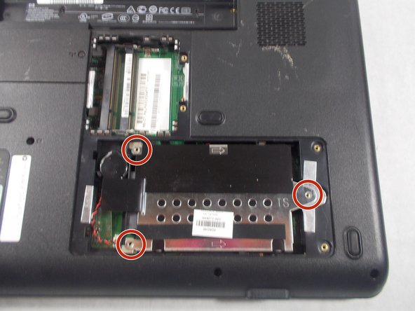

  • Identify the 3 screws holding the hard drive's cover in place.
  • Use a Phillips #0 screwdriver to remove the 3 screws and reveal the hard drive.
  • This particular laptop does not contain a hard drive-- yours will.
