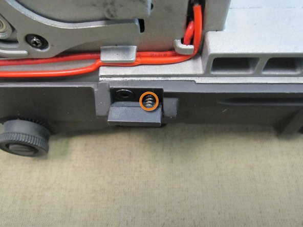

  • The next thing to do is remove the bolt catch. This will give you access to the small screw behind it which is part of the next step.
  • Punch out the the pin with either a thin punch or other appropriate tool. Once the pin is partially sticking out you can grab it with pliers.
  • Careful not to loose track of the spring behind the catch.
