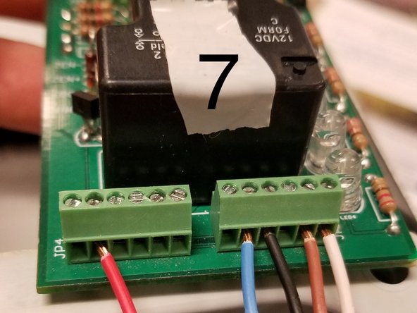

Rewire the autosampler connections
  • 7. Insert the wires and screw down using 260 / 1.5 x 40 flathead screwdriver until tight.
  • We do not use the green wire.
  • Hand tight is just right. Be careful not to over-tighten and crush the wire ferrules
  • 8. The battery connectors go in the fifth and sixth positions from the left.
  • If the battery connectors do not have the white caps, they will be only one red and one black wire. To make it easier to connect to the board, trim half of the copper wires off of each wire. and twist the reaming threads together. The red wire goes in the place where the red/white cap goes and the black wire goes where the black/green wire goes.
