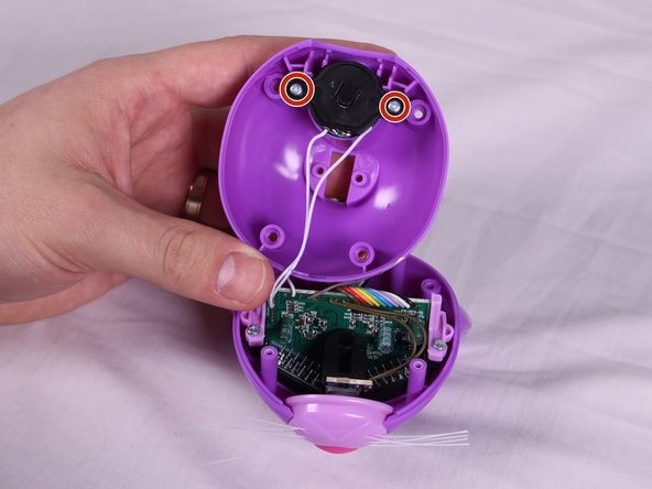

  • On the bottom half of the device's head, locate the two screws on each side of the speaker. Using the Phillips #1 driver remove the two 7mm screws.
  • Remove the black brace holding the speaker by gently pulling on it. The speaker will likely fall out after lifting the black brace.
