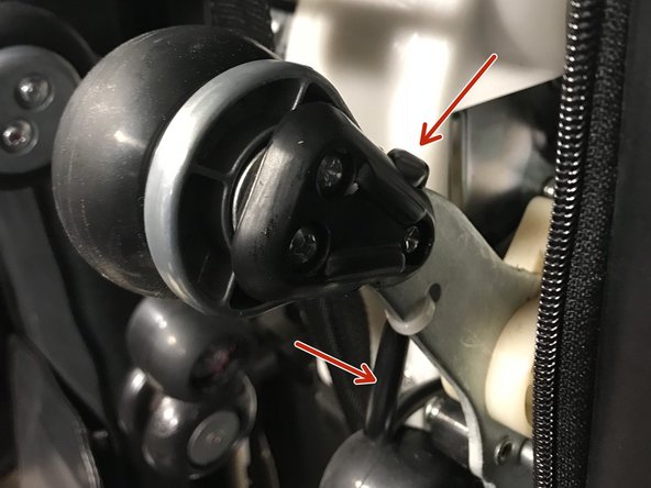

  • You will need to follow the heating element wire to the back side of the mechanism .
  • Wires are bundled in the marked area . Please cut all zip ties nessecary to access these wires.
  • These Wires do not use connectors they are capped together and share a connection with the opposing roller arm . Please cut , strip and re cap wires accordingly .
