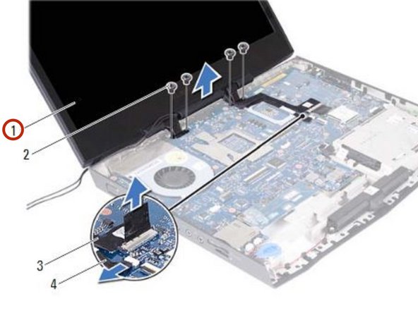

  • Slide the WirelessHD (optional) and mini-card antenna cables through the slot on the computer base.
  • Place the NEW display assembly in position and replace the screws that secure the display assembly to the computer base.
  • NOTE: Ensure that no cables lie between the display assembly and the computer base.
