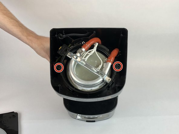

  • Remove the two 1.6mm Phillips #1 screws from the heating element.
  • Using a flathead screwdriver to remove the outer clips holding the heating unit in place.
  • Flip the heating element up to allow access to the circuit board.
