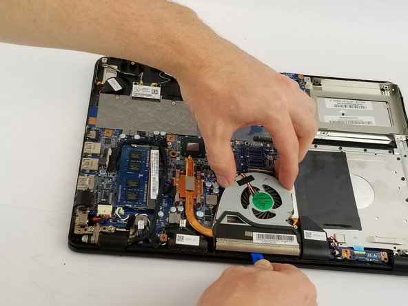

  • Once the prior two steps have been completed, obtain the plastic opening tool.
  • Gently place the plastic opening tool underneath the fan and separate the fan from the device by sliding the tool along the bottom of the fan.
  • Once separated, you can now lift the fan out by hand.
