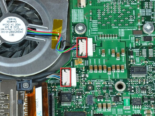

  • Disconnect both of the following connectors from the logic board:
  • Left fan cable.
  • Inverter cable.
  • Be sure to pull only parallel to the face of the logic board, as pulling up on the socket will break it off the logic board.
  • When pulling these connectors away from their sockets, it is helpful to use your fingernails to pull on the ears at each side of the connector.
