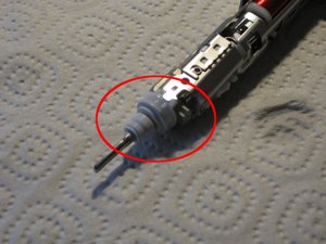

      Remove the brush head
      crwdns2936071:02crwdne2936071:0 — Remove lower cap
      Remove lower cap (2 plastic tabs). O-ring is already removed in this picture.

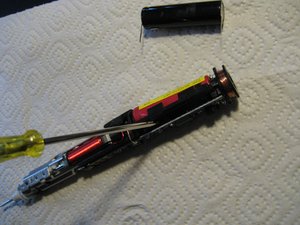

      crwdns2936071:03crwdne2936071:0 — Replace the battery
      Unwrap the battery and replace it (see Soldering Skills).
