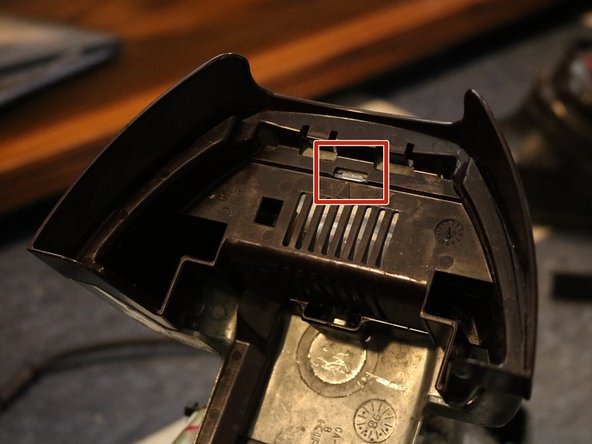

  • Push on the small plastic tab located at the top of the same part with a flat head
  • Pull lightly on the bulb cover to finish removing it
  • Unscrew the screws located inside the plastic holes.
  • Remove the metal cover by pulling up on it hard.
