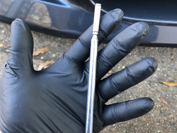

Tip
  • If you don't want to purchase a spark plug socket.
  • you can use a regular 16 hex mm socket.
  • Have a magnetic extension pen to gently connect the spark plugs and remove it out the bore.
