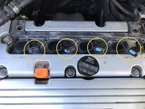

Remove Clips From Ignition Coil
  • Once clips are removed,
  • Pull the remove the Ignition Coil out and place them in order the way you have pulled them out.
  • You should see 4 holes where the spark plugs are located.
