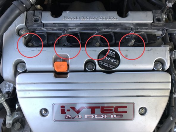

Remove the Spark Plug Wires
  • Use a 10 mm hex driver or socket to remove the four screws that are holding the Spark Plug wires in place.
  • Remove the spark plug wire by pinching the locking tabs on either side of it and pulling it out.
