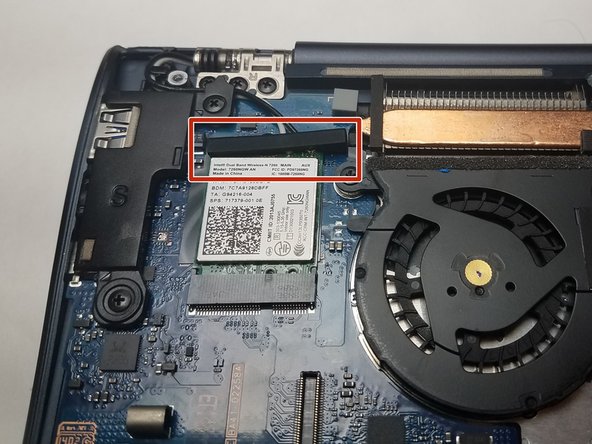

  • Remove the piece of foam that covers two antenna cable connectors.
  • Use the tip of a spudger or a fingernail to pry straight up and disconnect the antenna cable connectors.
