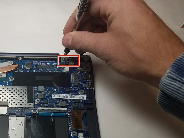

  • Unscrew the three 4.3 mm screws by using a #000 screwdriver located on the hinges in both corners of the laptop.
