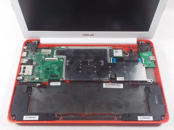

  • Start by removing the right speaker first.
  • There are two metal clips and one plastic clip holding the right speaker in place. Push them back and lift speaker out of the laptop.
  • Use a screwdriver to gently push back the metal clips.
