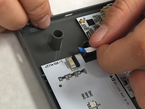

  • Pull the ribbon away from the black connector of the LED chips.
  • Disconnect the ribbon from the other LED chip as well, if replacing both LED chips or the motherboard.
