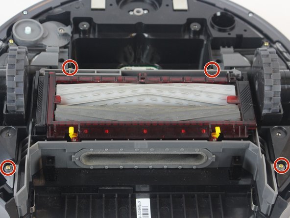

  • Remove the four 15.8mm gold screws around the brush module using the Phillips #1 screwdriver.
  • Lift the brush module carefully using both hands.
