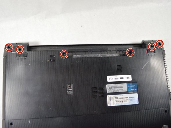

  • Remove the six 2 mm Phillips head screws on the top edge of the laptop using PH00 screw driver.
  • Flip the laptop right-side up and open the screen.
