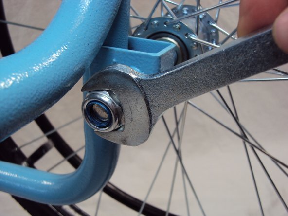

    • Remove the flat tire by loosening and removing the axle nut with a 19 mm wrench.
    • Unscrew the axle bolt with a 19 mm socket wrench.
    • Remove the axle bolt from hole and remove the wheel from the wheelchair.

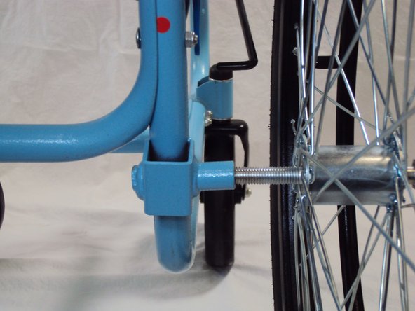

    • Insert the axle bolt into center of rear wheel.
    • Insert the wheel with the axle bolt into the lower back of the frame.
  6. the GEN 2 Wheelchair Tire Replacement: crwdns2935265:06crwdnd2935265:01crwdnd2935265:02crwdne2935265:0 the GEN 2 Wheelchair Tire Replacement: crwdns2935265:06crwdnd2935265:02crwdnd2935265:02crwdne2935265:0
    • Screw the bolt on the outside of the wheel with a 19 mm socket wrench.
    • Screw the nut on the inside of the wheel with a 19 mm wrench.
