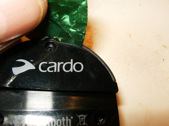

    • scala rider Q2 bike-to-bike intercom. Retail price $379.99 and never used.
    • Individual unit with carrying pouch
    • Back of the bluetooth intercom device

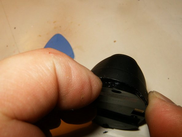

  3. scala rider Q2 multiSet battery replacement: crwdns2935265:03crwdnd2935265:01crwdnd2935265:03crwdne2935265:0 scala rider Q2 multiSet battery replacement: crwdns2935265:03crwdnd2935265:02crwdnd2935265:03crwdne2935265:0 scala rider Q2 multiSet battery replacement: crwdns2935265:03crwdnd2935265:03crwdnd2935265:03crwdne2935265:0
    • Insert a small guitar pick or similar tool to separate the individual halves. Start by the charging port end since this seems to be a better entry and not quite as tight.
    • Continue to use the pick left and right of the charging port. As the pick advances, one can feel the separation of the adhesive.
    • Multiple passes along the sides of the halves will be necesarry
  4. scala rider Q2 multiSet battery replacement: crwdns2935265:04crwdnd2935265:01crwdnd2935265:03crwdne2935265:0 scala rider Q2 multiSet battery replacement: crwdns2935265:04crwdnd2935265:02crwdnd2935265:03crwdne2935265:0 scala rider Q2 multiSet battery replacement: crwdns2935265:04crwdnd2935265:03crwdnd2935265:03crwdne2935265:0
    • Continue to advance the tool around the joint. It will take multiple passes to loosen the adhesive.
    • Once the joint widens, a plastic opening tool can also be used.
    • Once loosened enough, try to separate the parts manually.
  5. scala rider Q2 multiSet battery replacement: crwdns2935265:05crwdnd2935265:01crwdnd2935265:03crwdne2935265:0 scala rider Q2 multiSet battery replacement: crwdns2935265:05crwdnd2935265:02crwdnd2935265:03crwdne2935265:0 scala rider Q2 multiSet battery replacement: crwdns2935265:05crwdnd2935265:03crwdnd2935265:03crwdne2935265:0
    • Try to remove it carefully but with some force
    • Do not pry just pull and move along.

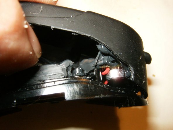

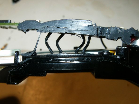

    • As the halves separate the vast amount of black silicone like adhesive becomes evident
  6. scala rider Q2 multiSet battery replacement: crwdns2935265:06crwdnd2935265:01crwdnd2935265:03crwdne2935265:0 scala rider Q2 multiSet battery replacement: crwdns2935265:06crwdnd2935265:02crwdnd2935265:03crwdne2935265:0 scala rider Q2 multiSet battery replacement: crwdns2935265:06crwdnd2935265:03crwdnd2935265:03crwdne2935265:0
    • Finally opened and the silicone like adhesive is everywhere.
    • The battery is sandwiched between the logicboard and the bottom of the case.

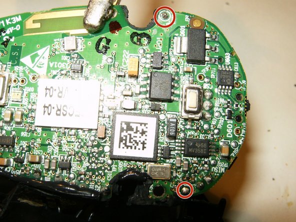

    • The logic board is fastened to the case by two T6 screws

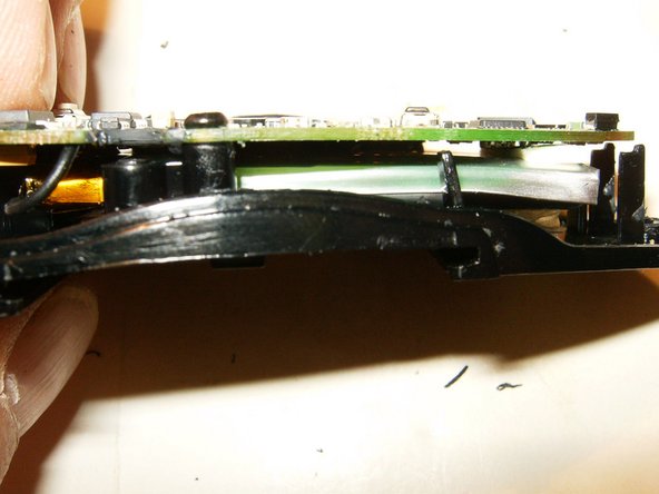

  7. scala rider Q2 multiSet battery replacement: crwdns2935265:07crwdnd2935265:01crwdnd2935265:03crwdne2935265:0 scala rider Q2 multiSet battery replacement: crwdns2935265:07crwdnd2935265:02crwdnd2935265:03crwdne2935265:0 scala rider Q2 multiSet battery replacement: crwdns2935265:07crwdnd2935265:03crwdnd2935265:03crwdne2935265:0
    • Both screws are the same length.
    • Lift the logic board gently of the case. Do not try to totally remove the board. There will be four wires that attach the board to the case as well as the battery cables.
    • With the board lifted remove the battery from the case. It is adhered with double sided tape and comes of relatively easy

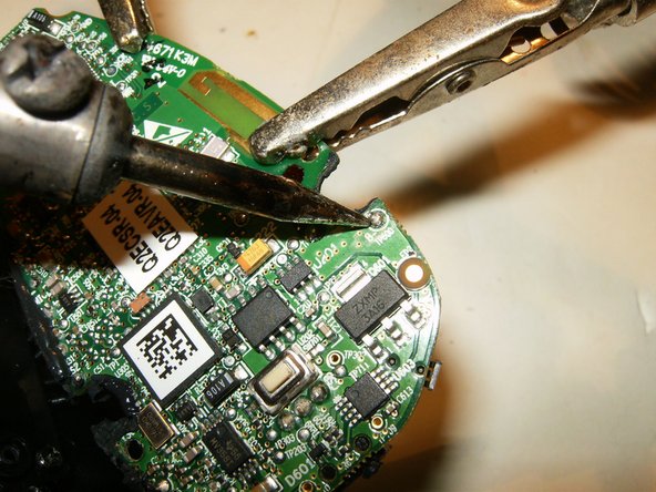

    • Rotate the board with the battery to the side where the four cables attach to the case
    • Identify the solder points for the battery cables
    • Unsolder one wire
  9. scala rider Q2 multiSet battery replacement: crwdns2935265:09crwdnd2935265:01crwdnd2935265:03crwdne2935265:0 scala rider Q2 multiSet battery replacement: crwdns2935265:09crwdnd2935265:02crwdnd2935265:03crwdne2935265:0 scala rider Q2 multiSet battery replacement: crwdns2935265:09crwdnd2935265:03crwdnd2935265:03crwdne2935265:0

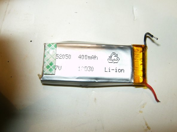

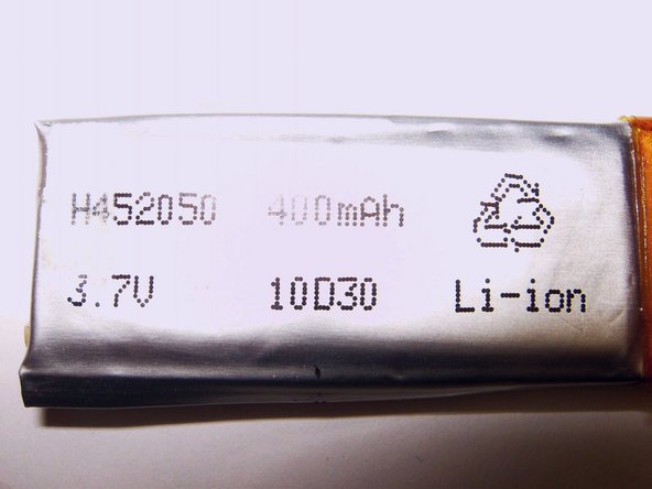

    • remove the battery
    • Here is the battery finally removed. Replacements are not readily available. The battery dimensions are 1.9" x 0.75" x 0.16" and it is a 3.7V 400mAh Li-Ion battery.

thanks for the info I will give it a go cheers Peter
Peter Gibson - crwdns2934203:0crwdne2934203:0
Thanks for your help, information perfect allowing easy battery replacement and unit now works a treat ☺️
gg1946 - crwdns2934203:0crwdne2934203:0
