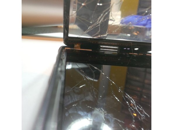

  3. samsung xcover 3 digitizer replacement Replacement: crwdns2935265:03crwdnd2935265:01crwdnd2935265:03crwdne2935265:0 samsung xcover 3 digitizer replacement Replacement: crwdns2935265:03crwdnd2935265:02crwdnd2935265:03crwdne2935265:0 samsung xcover 3 digitizer replacement Replacement: crwdns2935265:03crwdnd2935265:03crwdnd2935265:03crwdne2935265:0
    • removing the digitizer.
    • when you put the digitizer in a 90 degrees position , you'll see a flex cable. You can cut it with pliers.
    • the digitizer is loose.

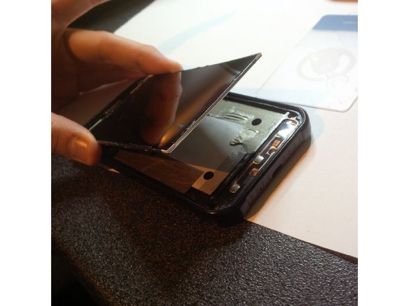

  4. samsung xcover 3 digitizer replacement Replacement, heating the lcd. step 1: crwdns2935265:04crwdnd2935265:01crwdnd2935265:03crwdne2935265:0 samsung xcover 3 digitizer replacement Replacement, heating the lcd. step 1: crwdns2935265:04crwdnd2935265:02crwdnd2935265:03crwdne2935265:0 samsung xcover 3 digitizer replacement Replacement, heating the lcd. step 1: crwdns2935265:04crwdnd2935265:03crwdnd2935265:03crwdne2935265:0
    • again heat the Phone to loose the adhesive under the lcd screen.
    • heat the Phone also at the back.
    • again don't heat to much...
  5. samsung xcover 3 digitizer replacement Replacement, heating the lcd and removing it step 2: crwdns2935265:05crwdnd2935265:01crwdnd2935265:02crwdne2935265:0 samsung xcover 3 digitizer replacement Replacement, heating the lcd and removing it step 2: crwdns2935265:05crwdnd2935265:02crwdnd2935265:02crwdne2935265:0
    • use a spudger to go under the screen but do this very very gently. Take your time.

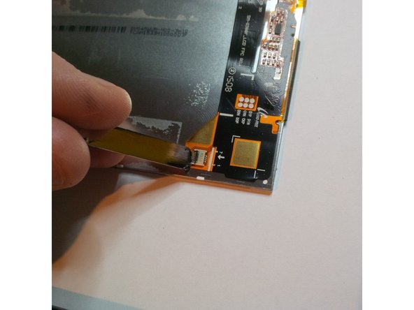

  6. samsung xcover 3 digitizer replacement Replacement: crwdns2935265:06crwdnd2935265:01crwdnd2935265:03crwdne2935265:0 samsung xcover 3 digitizer replacement Replacement: crwdns2935265:06crwdnd2935265:02crwdnd2935265:03crwdne2935265:0 samsung xcover 3 digitizer replacement Replacement: crwdns2935265:06crwdnd2935265:03crwdnd2935265:03crwdne2935265:0
    • put the lcd in a 90 degrees position. You'll see in picture 1 there is a plastic lid and a tiny screw. remove the screw and the plastic lid.
    • under the lid there is a flex cable. use a spudger to remove the cable.

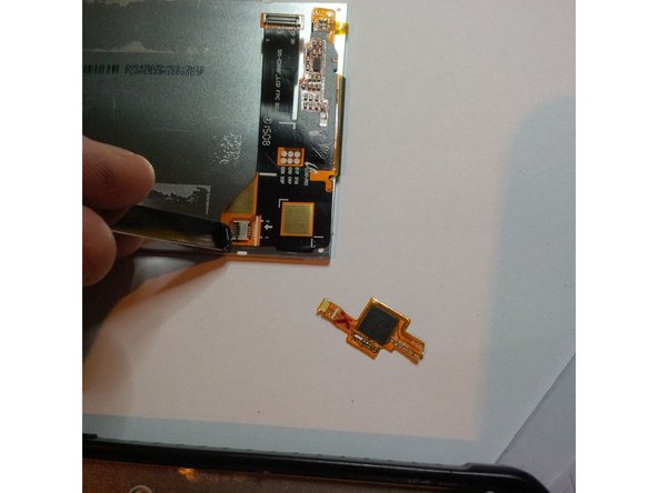

  7. samsung xcover 3 digitizer replacement Replacement: crwdns2935265:07crwdnd2935265:01crwdnd2935265:03crwdne2935265:0 samsung xcover 3 digitizer replacement Replacement: crwdns2935265:07crwdnd2935265:02crwdnd2935265:03crwdne2935265:0 samsung xcover 3 digitizer replacement Replacement: crwdns2935265:07crwdnd2935265:03crwdnd2935265:03crwdne2935265:0
    • a few steps ago you had to cut the cable from the digitizer. now you see that piece is still on the board at the lcd screen. use a spudger to open the connector's lid and remove the rest of the cable.

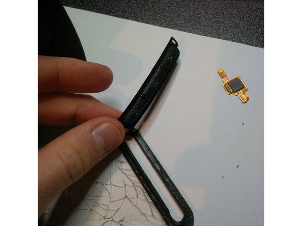

  8. samsung xcover 3 digitizer replacement Replacement: crwdns2935265:08crwdnd2935265:01crwdnd2935265:03crwdne2935265:0 samsung xcover 3 digitizer replacement Replacement: crwdns2935265:08crwdnd2935265:02crwdnd2935265:03crwdne2935265:0 samsung xcover 3 digitizer replacement Replacement: crwdns2935265:08crwdnd2935265:03crwdnd2935265:03crwdne2935265:0
    • take the old broken digitizer and remove the plastic/rubber buttons., there is adhesive so you have to use the spudger to peel it off..
