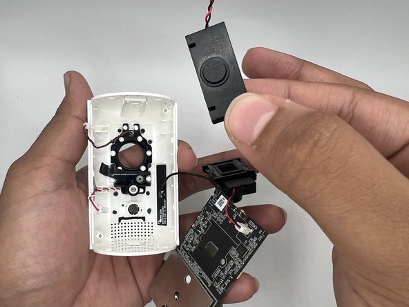

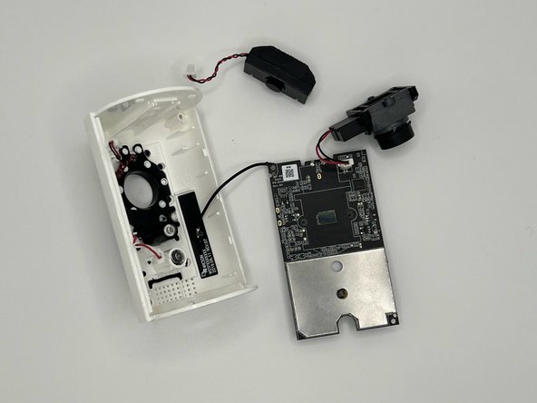

  5. ring Indoor Cam Speaker Replacement, Motherboard: crwdns2935265:05crwdnd2935265:01crwdnd2935265:03crwdne2935265:0 ring Indoor Cam Speaker Replacement, Motherboard: crwdns2935265:05crwdnd2935265:02crwdnd2935265:03crwdne2935265:0 ring Indoor Cam Speaker Replacement, Motherboard: crwdns2935265:05crwdnd2935265:03crwdnd2935265:03crwdne2935265:0
    • Gently remove the three white leads from their sockets on the top of the motherboard.
  6. ring Indoor Cam Speaker Replacement: crwdns2935265:06crwdnd2935265:01crwdnd2935265:02crwdne2935265:0 ring Indoor Cam Speaker Replacement: crwdns2935265:06crwdnd2935265:02crwdnd2935265:02crwdne2935265:0
    • Using a Phillips #00 screwdriver, remove the two 4.7 mm black screws located in the corners of the motherboard.
    • Using a Phillips #00 screwdriver, remove the two silver 5 mm screws in the center of the motherboard.
  7. ring Indoor Cam Speaker Replacement: crwdns2935265:07crwdnd2935265:01crwdnd2935265:03crwdne2935265:0 ring Indoor Cam Speaker Replacement: crwdns2935265:07crwdnd2935265:02crwdnd2935265:03crwdne2935265:0 ring Indoor Cam Speaker Replacement: crwdns2935265:07crwdnd2935265:03crwdnd2935265:03crwdne2935265:0
    • Use the iFixit opening pick to pry the motherboard from the body of the camera.
  8. ring Indoor Cam Speaker Replacement: crwdns2935265:08crwdnd2935265:01crwdnd2935265:02crwdne2935265:0 ring Indoor Cam Speaker Replacement: crwdns2935265:08crwdnd2935265:02crwdnd2935265:02crwdne2935265:0
    • Detach the black wire connecting the motherboard to the body of the camera.
  9. ring Indoor Cam Speaker Replacement, Speaker: crwdns2935265:09crwdnd2935265:01crwdnd2935265:03crwdne2935265:0 ring Indoor Cam Speaker Replacement, Speaker: crwdns2935265:09crwdnd2935265:02crwdnd2935265:03crwdne2935265:0 ring Indoor Cam Speaker Replacement, Speaker: crwdns2935265:09crwdnd2935265:03crwdnd2935265:03crwdne2935265:0
    • Gently remove the speaker using the spudger.
