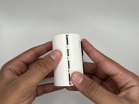

  2. ring Indoor Cam Motherboard Replacement: crwdns2935265:02crwdnd2935265:01crwdnd2935265:02crwdne2935265:0 ring Indoor Cam Motherboard Replacement: crwdns2935265:02crwdnd2935265:02crwdnd2935265:02crwdne2935265:0
    • Place the cam with the top facing toward you.
    • Insert the iFixit opening pick into the crease at the top of the camera.
    • Slide the pick along the crease until you can separate the top cover of the camera from the backing.
    • Leave the pick in the crease.

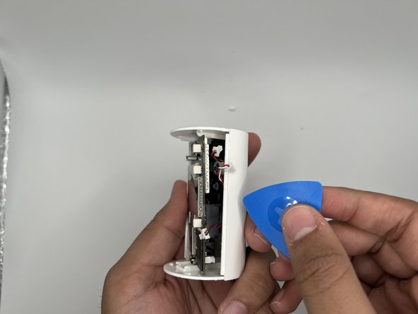

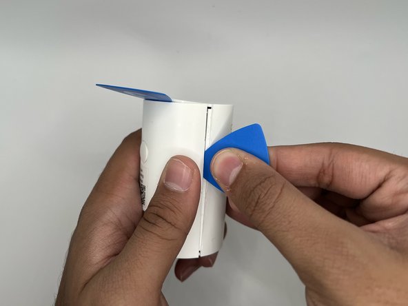

  3. ring Indoor Cam Motherboard Replacement: crwdns2935265:03crwdnd2935265:01crwdnd2935265:02crwdne2935265:0 ring Indoor Cam Motherboard Replacement: crwdns2935265:03crwdnd2935265:02crwdnd2935265:02crwdne2935265:0
    • Place the camera on its side where the horizontal crease is facing you.
    • Insert another iFixit opening pick into the crease between the front and back portions of the camera.

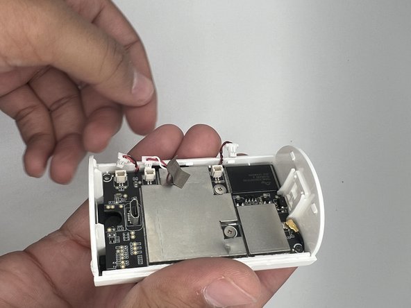

  4. ring Indoor Cam Motherboard Replacement: crwdns2935265:04crwdnd2935265:01crwdnd2935265:03crwdne2935265:0 ring Indoor Cam Motherboard Replacement: crwdns2935265:04crwdnd2935265:02crwdnd2935265:03crwdne2935265:0 ring Indoor Cam Motherboard Replacement: crwdns2935265:04crwdnd2935265:03crwdnd2935265:03crwdne2935265:0
    • Slide the pick along the vertical crease until you can remove the back cover of the cam, using the opening tool to pry the portions apart.
    • You may hear a popping noise when you pry it open.

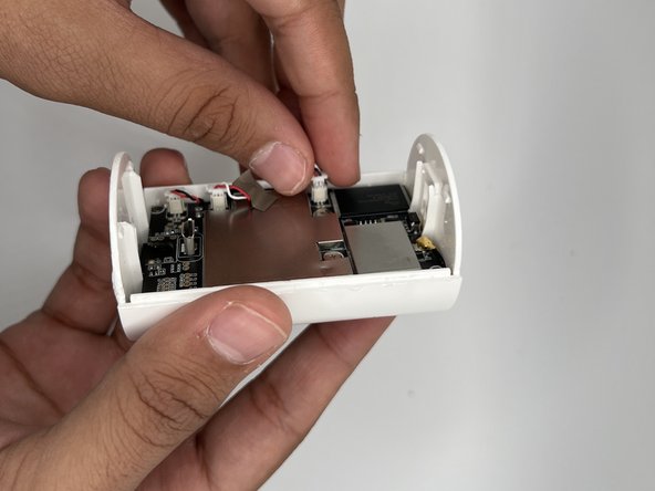

  5. ring Indoor Cam Motherboard Replacement, Motherboard: crwdns2935265:05crwdnd2935265:01crwdnd2935265:03crwdne2935265:0 ring Indoor Cam Motherboard Replacement, Motherboard: crwdns2935265:05crwdnd2935265:02crwdnd2935265:03crwdne2935265:0 ring Indoor Cam Motherboard Replacement, Motherboard: crwdns2935265:05crwdnd2935265:03crwdnd2935265:03crwdne2935265:0
    • Gently remove the three white leads from their sockets on the top of the motherboard.

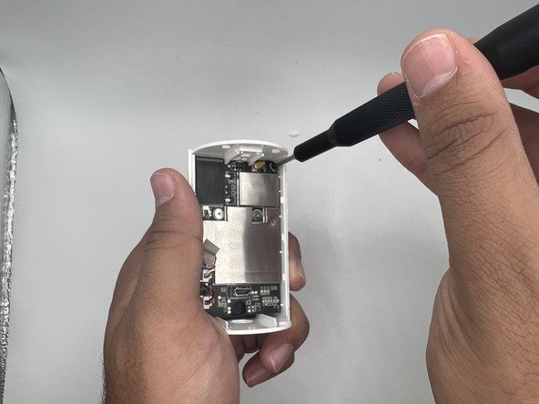

  6. ring Indoor Cam Motherboard Replacement: crwdns2935265:06crwdnd2935265:01crwdnd2935265:02crwdne2935265:0 ring Indoor Cam Motherboard Replacement: crwdns2935265:06crwdnd2935265:02crwdnd2935265:02crwdne2935265:0
    • Using a Phillips #00 screwdriver, remove the two 4.7 mm black screws located in the corners of the motherboard.
    • Using a Phillips #00 screwdriver, remove the two silver 5 mm screws in the center of the motherboard.

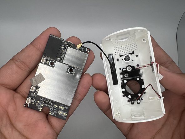

  7. ring Indoor Cam Motherboard Replacement: crwdns2935265:07crwdnd2935265:01crwdnd2935265:03crwdne2935265:0 ring Indoor Cam Motherboard Replacement: crwdns2935265:07crwdnd2935265:02crwdnd2935265:03crwdne2935265:0 ring Indoor Cam Motherboard Replacement: crwdns2935265:07crwdnd2935265:03crwdnd2935265:03crwdne2935265:0

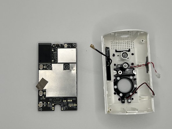

    • Use the iFixit opening pick to pry the motherboard from the body of the camera.
  8. ring Indoor Cam Motherboard Replacement: crwdns2935265:08crwdnd2935265:01crwdnd2935265:02crwdne2935265:0 ring Indoor Cam Motherboard Replacement: crwdns2935265:08crwdnd2935265:02crwdnd2935265:02crwdne2935265:0
    • Detach the black wire connecting the motherboard to the body of the camera.
