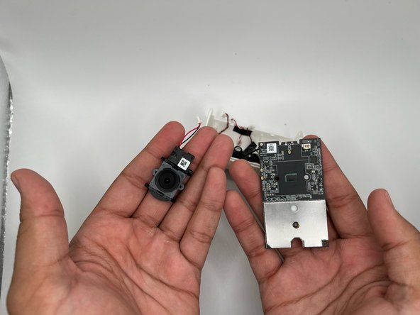

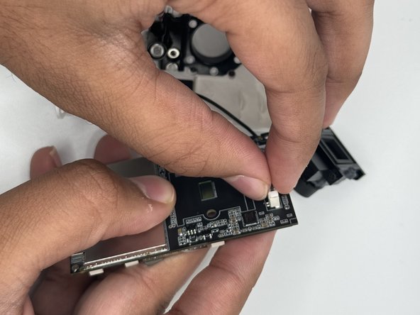

  9. ring Indoor Cam Camera Replacement, Camera: crwdns2935265:09crwdnd2935265:01crwdnd2935265:03crwdne2935265:0 ring Indoor Cam Camera Replacement, Camera: crwdns2935265:09crwdnd2935265:02crwdnd2935265:03crwdne2935265:0 ring Indoor Cam Camera Replacement, Camera: crwdns2935265:09crwdnd2935265:03crwdnd2935265:03crwdne2935265:0
    • Gently turn to the motherboard's backside and remove the white leads connecting the camera to the socket in the motherboard.
    • Cautiously remove the camera.
