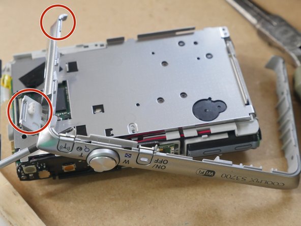

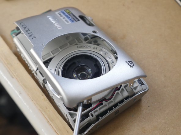

  3. nikon s3700 Lens Replacement, Lens: crwdns2935265:03crwdnd2935265:01crwdnd2935265:03crwdne2935265:0 nikon s3700 Lens Replacement, Lens: crwdns2935265:03crwdnd2935265:02crwdnd2935265:03crwdne2935265:0 nikon s3700 Lens Replacement, Lens: crwdns2935265:03crwdnd2935265:03crwdnd2935265:03crwdne2935265:0
    • Remove screws
    • Remove front housing case
    • Remove top cabinet part
    • The two areas highlighted in red have loose parts. Please keep your eyes on these parts because they can get lost easily. Once you remove the top cabinet they will most likely fall off. In particular, there is a tiny spring behind the battery retainer which is very easy to loose.
