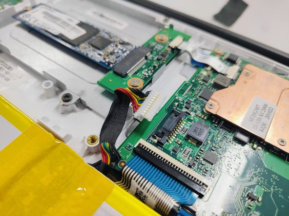

  9. jp.ik Leap T304 Battery Replacement Replacement: crwdns2935265:09crwdnd2935265:01crwdnd2935265:02crwdne2935265:0 jp.ik Leap T304 Battery Replacement Replacement: crwdns2935265:09crwdnd2935265:02crwdnd2935265:02crwdne2935265:0
    • Disconnect the cable marked in the figure gently, pulling it out of the connector.

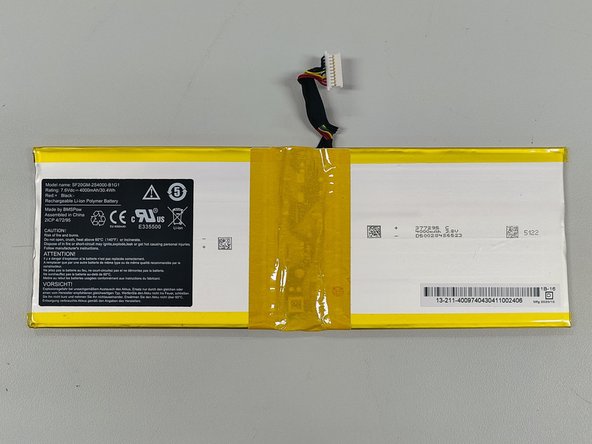

  10. jp.ik Leap T304 Battery Replacement Replacement: crwdns2935265:010crwdnd2935265:01crwdnd2935265:02crwdne2935265:0 jp.ik Leap T304 Battery Replacement Replacement: crwdns2935265:010crwdnd2935265:02crwdnd2935265:02crwdne2935265:0
    • Gently remove the battery.
    • CAUTION!!
    • Some products may have this battery fixed with double-sided adhesive tape. In these cases, use a wide spatula to remove the battery without bending it.
    • SAFETY WARNING!
    • Never bend or puncture the battery. Danger of explosion. If you detect a swollen or damaged battery, handle it with extreme care and place it in a protective container.
