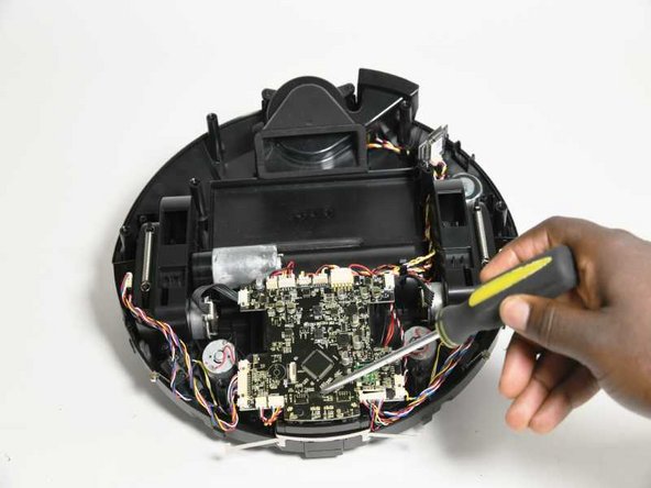

  5. ionvac SmartClean V2 Side Brush Motors Replacement, Side Brush Motors: crwdns2935265:05crwdnd2935265:01crwdnd2935265:01crwdne2935265:0
    • Identify the 2 side brush motors that look like cylinders on the bottom shelf of your ionvac.
  6. ionvac SmartClean V2 Side Brush Motors Replacement: crwdns2935265:06crwdnd2935265:01crwdnd2935265:02crwdne2935265:0 ionvac SmartClean V2 Side Brush Motors Replacement: crwdns2935265:06crwdnd2935265:02crwdnd2935265:02crwdne2935265:0
    • Remove the 3 screws that attach the motor to the bottom shelf.
    • Lift the motor out of its slot.
