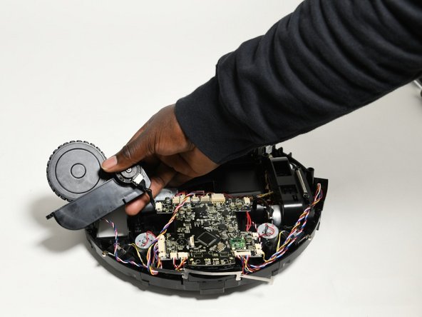

    • Unscrew the 3 screws securing the motor wheel frame.
    • Dislodge the wheel motor frame from the bottom shelf.
  7. ionvac SmartClean V2 Motor Wheel Replacement: crwdns2935265:07crwdnd2935265:01crwdnd2935265:01crwdne2935265:0
    • Disconnect the cable attaching the motor wheel frame to the logic board.

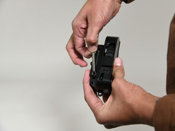

    • Carefully pull one end of the spring out of place to remove it from the motor wheel frame.
    • This will separate the motor wheel frame from the motor wheel assembly.

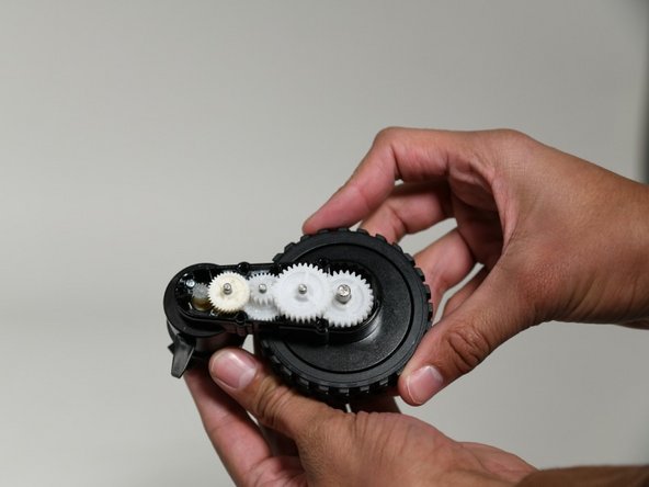

    • Gently lift the clip on the side to separate the casing and expose the white plastic gears.
  11. ionvac SmartClean V2 Motor Wheel Replacement: crwdns2935265:011crwdnd2935265:01crwdnd2935265:01crwdne2935265:0
    • Remove all but the largest gear to expose the silver screws and washers underneath.
    • Unscrew and remove the two silver screws along with each accompanying set of two washers.
    • Now you can remove the motor from the wheel assembly.
    • To clean the motor, use a soft cloth or alcohol wipe.
