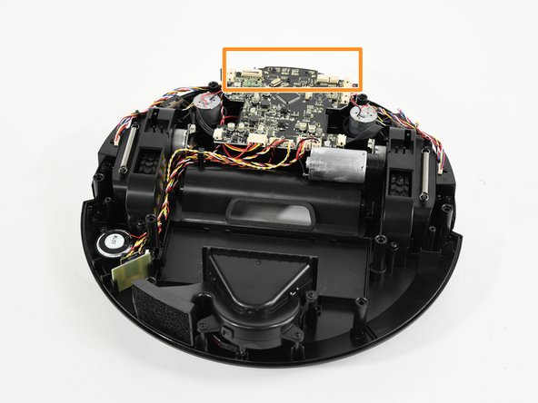

    • The bottom shell includes motors for the wheels, the logic board, and the main vacuum.
    • There are three sensor slits on the top shell that allow protect the interior from damage without covering the sensors.
    • When putting back together, ensure that these sensor slits are aligned towards the logic board side.

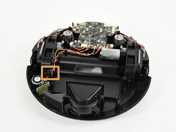

  7. ionvac SmartClean V2 Internal Configuration: crwdns2935265:07crwdnd2935265:01crwdnd2935265:02crwdne2935265:0 ionvac SmartClean V2 Internal Configuration: crwdns2935265:07crwdnd2935265:02crwdnd2935265:02crwdne2935265:0
    • Ensure that this wedge piece for the filter is still oriented in its appropriate place.
    • It is located near the motor beside the filter.

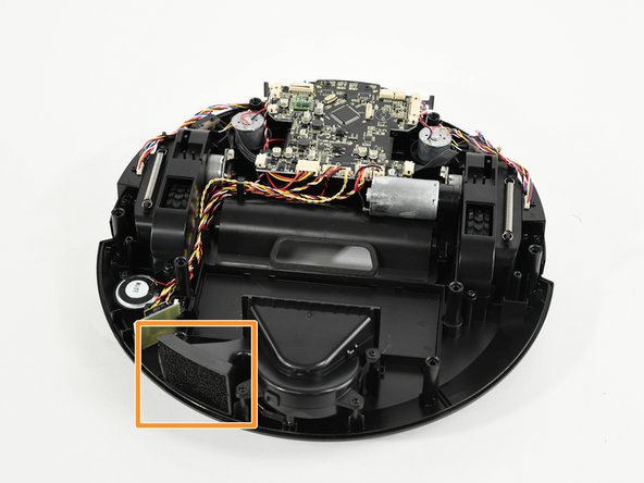

  8. ionvac SmartClean V2 Internal Configuration: crwdns2935265:08crwdnd2935265:01crwdnd2935265:02crwdne2935265:0 ionvac SmartClean V2 Internal Configuration: crwdns2935265:08crwdnd2935265:02crwdnd2935265:02crwdne2935265:0
    • Ensure that the vacuum filter is still oriented upright in the filter casing.
    • It is located on the end of the bottom shelf, opposite the logic board.

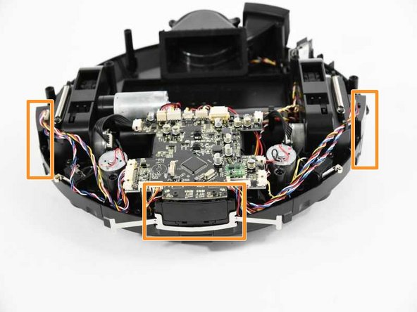

  9. ionvac SmartClean V2 Internal Configuration: crwdns2935265:09crwdnd2935265:01crwdnd2935265:02crwdne2935265:0 ionvac SmartClean V2 Internal Configuration: crwdns2935265:09crwdnd2935265:02crwdnd2935265:02crwdne2935265:0
    • The metal bumper, located at the front of the vacuum, should be oriented upright on the sensors.
    • It is located on the outside of the bottom shell, at the head of the logic board.
