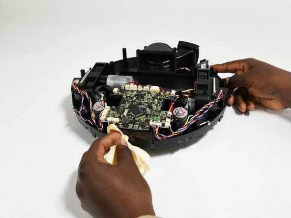

  4. ionvac SmartClean V2 Bumper Sensor Replacement: crwdns2935265:04crwdnd2935265:01crwdnd2935265:02crwdne2935265:0 ionvac SmartClean V2 Bumper Sensor Replacement: crwdns2935265:04crwdnd2935265:02crwdnd2935265:02crwdne2935265:0
    • Lift the top shell off carefully.

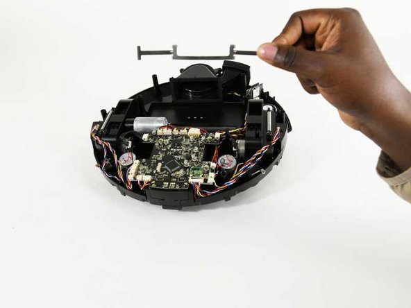

  5. ionvac SmartClean V2 Bumper Sensor Replacement, Bumper Sensor: crwdns2935265:05crwdnd2935265:01crwdnd2935265:03crwdne2935265:0 ionvac SmartClean V2 Bumper Sensor Replacement, Bumper Sensor: crwdns2935265:05crwdnd2935265:02crwdnd2935265:03crwdne2935265:0 ionvac SmartClean V2 Bumper Sensor Replacement, Bumper Sensor: crwdns2935265:05crwdnd2935265:03crwdnd2935265:03crwdne2935265:0
    • Turn your ionvac so that the sensor and the metal bumper piece are facing forward.
    • Gently lift and remove the bumper for cleaning or replacement.
