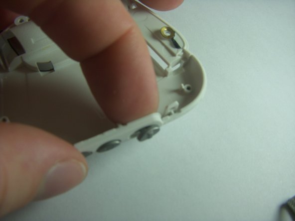

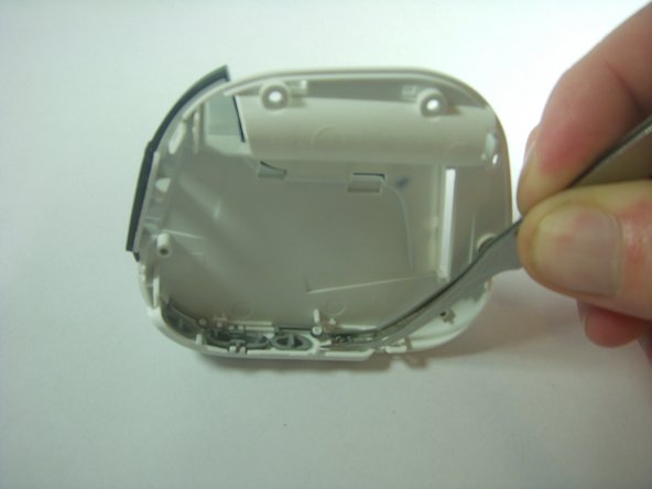

  8. ilo 1Gb Mp3 Player External volume button and hold switch Replacement, Volume Rocker: crwdns2935265:08crwdnd2935265:01crwdnd2935265:02crwdne2935265:0 ilo 1Gb Mp3 Player External volume button and hold switch Replacement, Volume Rocker: crwdns2935265:08crwdnd2935265:02crwdnd2935265:02crwdne2935265:0
    • Remove the Volume button from its rocker socket by gently pushing in on the button until it pops out if the two sockets.

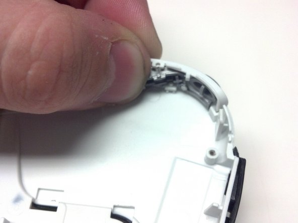

  9. ilo 1Gb Mp3 Player External volume button and hold switch Replacement, Hold Switch: crwdns2935265:09crwdnd2935265:01crwdnd2935265:03crwdne2935265:0 ilo 1Gb Mp3 Player External volume button and hold switch Replacement, Hold Switch: crwdns2935265:09crwdnd2935265:02crwdnd2935265:03crwdne2935265:0 ilo 1Gb Mp3 Player External volume button and hold switch Replacement, Hold Switch: crwdns2935265:09crwdnd2935265:03crwdnd2935265:03crwdne2935265:0
    • Remove Hold Switch from Socket by squeezing the prongs that hold the button in the socket together and push the button outward.
