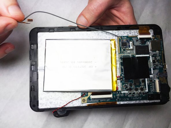

  3. iView-776TPCII Wi-Fi Antenna Replacement, Wi-Fi Antenna: crwdns2935265:03crwdnd2935265:01crwdnd2935265:02crwdne2935265:0 iView-776TPCII Wi-Fi Antenna Replacement, Wi-Fi Antenna: crwdns2935265:03crwdnd2935265:02crwdnd2935265:02crwdne2935265:0
    • Detach the end of the Wi-Fi antenna from the tape on the edge of the shell.
  4. iView-776TPCII Wi-Fi Antenna Replacement: crwdns2935265:04crwdnd2935265:01crwdnd2935265:01crwdne2935265:0
    • Use the Portable Soldering Iron tool to heat the lead coming from the Wi-Fi antenna to the logic board, thereby breaking the connection.
    • For help on soldering, refer to the iFixit "How To Solder and Desolder Connections" technique guide as necessary.
    • Once heated, use tweezers to pull the wire free from its connection.
