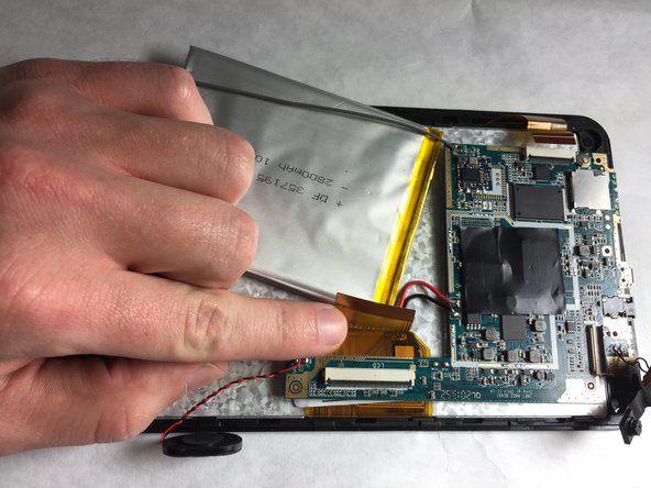

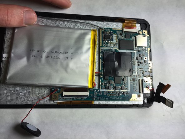

    1. iView-776TPCII Motherboard Replacement, Battery: crwdns2935265:03crwdnd2935265:01crwdnd2935265:01crwdne2935265:0
      • Insert the flat side of the standard spudger underneath the battery and use a prying action to loosen the glue holding it to the digitizer.
      • Do this all around the battery until it comes off.
      • The glue is strong, so some force may be required. However, be careful not to apply so much pressure that the battery bends or breaks.
      • At this point, do not attempt to fully remove the battery, since it is still connected to the motherboard.

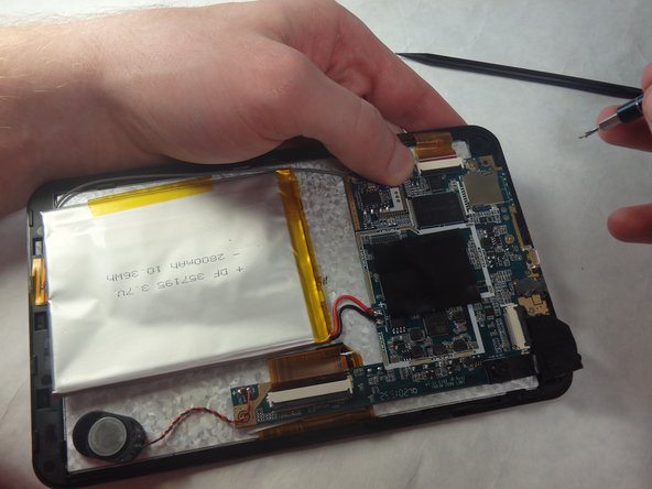

    2. iView-776TPCII Motherboard Replacement: crwdns2935265:04crwdnd2935265:01crwdnd2935265:01crwdne2935265:0
      • Use the Portable Soldering Iron tool to heat the leads coming from the battery to the motherboard, thereby breaking the connection.
      • For help on soldering, refer to the iFixit "How To Solder and Desolder Connections" technique guide as necessary.
      • Once heated, use tweezers to pull the wires free from their connections.
      • To ease reassembly, take note of which wire went to the positive and negative terminals.

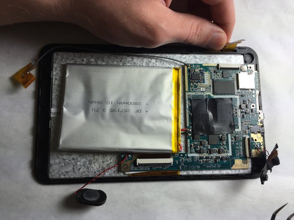

    1. iView-776TPCII Motherboard Replacement, Wi-Fi Antenna: crwdns2935265:05crwdnd2935265:01crwdnd2935265:02crwdne2935265:0 iView-776TPCII Motherboard Replacement, Wi-Fi Antenna: crwdns2935265:05crwdnd2935265:02crwdnd2935265:02crwdne2935265:0
      • Detach the end of the Wi-Fi antenna from the tape on the edge of the shell.
    2. iView-776TPCII Motherboard Replacement: crwdns2935265:06crwdnd2935265:01crwdnd2935265:01crwdne2935265:0
      • Use the Portable Soldering Iron tool to heat the lead coming from the Wi-Fi antenna to the logic board, thereby breaking the connection.
      • Once heated, use tweezers to pull the wire free from its connection.

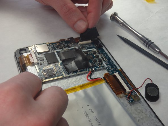

    1. iView-776TPCII Motherboard Replacement, Camera Assembly: crwdns2935265:07crwdnd2935265:01crwdnd2935265:02crwdne2935265:0 iView-776TPCII Motherboard Replacement, Camera Assembly: crwdns2935265:07crwdnd2935265:02crwdnd2935265:02crwdne2935265:0
      Heavy-Duty Spudger
      • The camera module is located in the upper-right corner of the tablet.
      • Loosen the edges of the black tape covering the camera using the heavy-duty spudger.
      • Use the freed edges of the tape to gently remove the camera assembly from its plastic housing.
      • The camera assembly will still be connected to the rest of the device via a ribbon cable. Take care so as not to tear this connection.
    2. iView-776TPCII Motherboard Replacement: crwdns2935265:08crwdnd2935265:01crwdnd2935265:02crwdne2935265:0 iView-776TPCII Motherboard Replacement: crwdns2935265:08crwdnd2935265:02crwdnd2935265:02crwdne2935265:0
      • Use tweezers to lift the cover off the top of the camera's ZIF adapter.
      • When reassembling the device, be sure to fully secure the ribbon cable from the camera back into the ZIF adapter.
      • Pull the assembly away from the motherboard with a set of tweezers to prepare for desoldering.
    3. iView-776TPCII Motherboard Replacement: crwdns2935265:09crwdnd2935265:01crwdnd2935265:01crwdne2935265:0
      • Use the Portable Soldering Iron tool to heat the leads coming from the camera assembly to the motherboard, thereby breaking the connection.

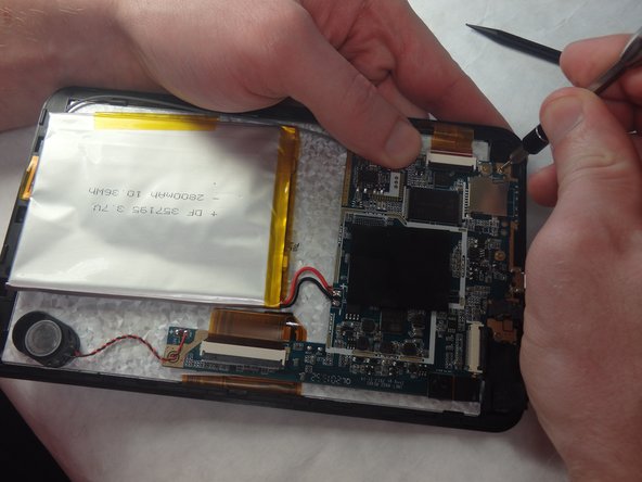

    1. iView-776TPCII Motherboard Replacement, Motherboard: crwdns2935265:010crwdnd2935265:01crwdnd2935265:03crwdne2935265:0 iView-776TPCII Motherboard Replacement, Motherboard: crwdns2935265:010crwdnd2935265:02crwdnd2935265:03crwdne2935265:0 iView-776TPCII Motherboard Replacement, Motherboard: crwdns2935265:010crwdnd2935265:03crwdnd2935265:03crwdne2935265:0
      • Remove the three 2.2mm Phillips head screws using a screwdriver to loosen the motherboard from the shell.
      • Check "Screwdriver Best Practices" as needed for help on how to properly use a screwdriver with your device.

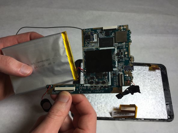

    2. iView-776TPCII Motherboard Replacement: crwdns2935265:011crwdnd2935265:01crwdnd2935265:02crwdne2935265:0 iView-776TPCII Motherboard Replacement: crwdns2935265:011crwdnd2935265:02crwdnd2935265:02crwdne2935265:0
      • Use the 45 degree tweezers to lift the black section of the digitizer ZIF adapter to release the ribbon. Gently pull the ribbon cable out of its socket.
      • When reassembling the device, be sure to fully secure the ribbon cable back into the ZIF adapter.
    3. iView-776TPCII Motherboard Replacement: crwdns2935265:012crwdnd2935265:01crwdnd2935265:03crwdne2935265:0 iView-776TPCII Motherboard Replacement: crwdns2935265:012crwdnd2935265:02crwdnd2935265:03crwdne2935265:0 iView-776TPCII Motherboard Replacement: crwdns2935265:012crwdnd2935265:03crwdnd2935265:03crwdne2935265:0
      • Use the 45 degree tweezers to lift the black section of the LCD ZIF adapter to release the ribbon. Gently pull the ribbon cable out of its socket.
      • The motherboard is now separated from the digitizer and front panel and can be safely removed from the device.
