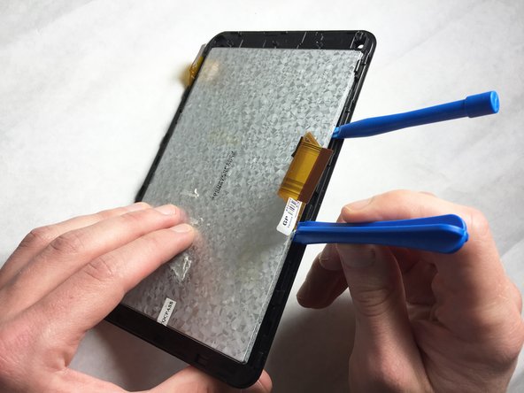

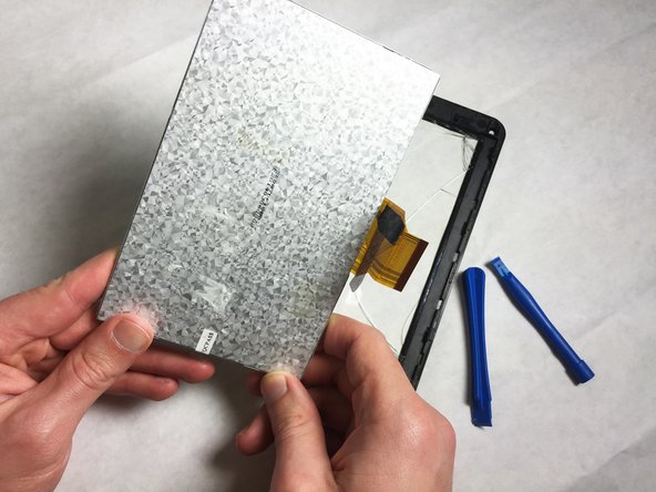

    1. iView-776TPCII Digitizer Replacement, Digitizer: crwdns2935265:013crwdnd2935265:01crwdnd2935265:03crwdne2935265:0 iView-776TPCII Digitizer Replacement, Digitizer: crwdns2935265:013crwdnd2935265:02crwdnd2935265:03crwdne2935265:0 iView-776TPCII Digitizer Replacement, Digitizer: crwdns2935265:013crwdnd2935265:03crwdnd2935265:03crwdne2935265:0
      • Insert the plastic opening tool between the digitizer and the screen. Use a prying motion to loosen the digitizer from its plastic case.
      • If you find it hard to separate the two components at first, try to use another plastic opening tool for support.
      • Continue moving along the edge of the digitizer until it is fully separated.
