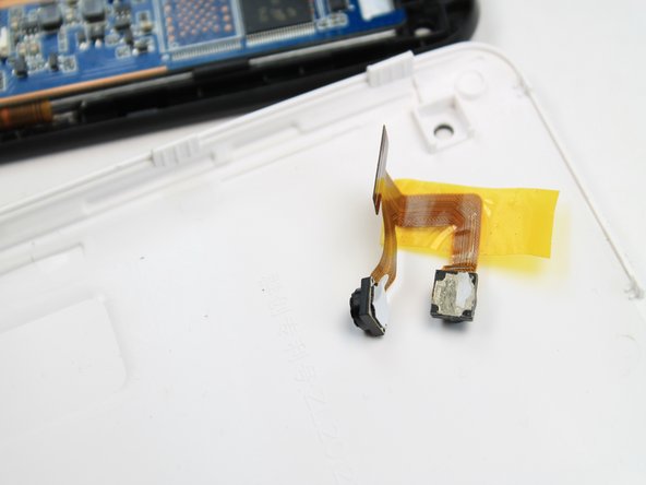

  3. iVIEW-754TPC Logic Board Replacement, Camera Assembly: crwdns2935265:03crwdnd2935265:01crwdnd2935265:03crwdne2935265:0 iVIEW-754TPC Logic Board Replacement, Camera Assembly: crwdns2935265:03crwdnd2935265:02crwdnd2935265:03crwdne2935265:0 iVIEW-754TPC Logic Board Replacement, Camera Assembly: crwdns2935265:03crwdnd2935265:03crwdnd2935265:03crwdne2935265:0
    • The camera module is located directly under the top right corner of the back cover.
    • Peel back the tape holding down the camera ribbon connector using a pair of tweezers.
    • As you peel the tape backward, the front facing camera may come out, this is not an issue.
    • If the front facing camera does not come out, gently lift it out with a pair of tweezers
  4. iVIEW-754TPC Logic Board Replacement, Remove Camera: crwdns2935265:04crwdnd2935265:01crwdnd2935265:02crwdne2935265:0 iVIEW-754TPC Logic Board Replacement, Remove Camera: crwdns2935265:04crwdnd2935265:02crwdnd2935265:02crwdne2935265:0
    • Use a spudger to lift flap on top of the camera ZIF adapter.
    • At this point the camera module can be easily removed with a pair of tweezers.
    • During reassembly, make sure you put the ZIF adapter snugly back into its socket and secure the flap.

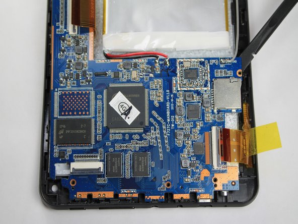

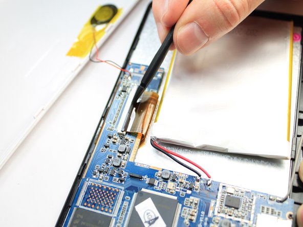

  5. iVIEW-754TPC Logic Board Replacement, Logic Board: crwdns2935265:05crwdnd2935265:01crwdnd2935265:01crwdne2935265:0
    • Remove the four 2.2mm Phillips screws holding the logic board in place. Place the screws on the iFixit magnetic project mat.

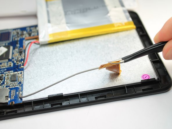

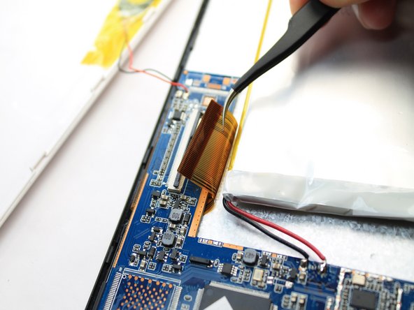

  6. iVIEW-754TPC Logic Board Replacement, WIFI Antenna: crwdns2935265:06crwdnd2935265:01crwdnd2935265:02crwdne2935265:0 iVIEW-754TPC Logic Board Replacement, WIFI Antenna: crwdns2935265:06crwdnd2935265:02crwdnd2935265:02crwdne2935265:0
    • Gently peel the WIFI Antenna up using a pair of tweezers.

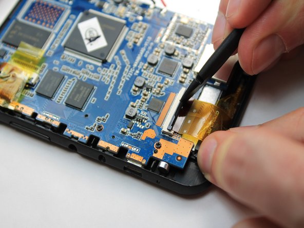

  7. iVIEW-754TPC Logic Board Replacement, Disconnect LCD: crwdns2935265:07crwdnd2935265:01crwdnd2935265:03crwdne2935265:0 iVIEW-754TPC Logic Board Replacement, Disconnect LCD: crwdns2935265:07crwdnd2935265:02crwdnd2935265:03crwdne2935265:0 iVIEW-754TPC Logic Board Replacement, Disconnect LCD: crwdns2935265:07crwdnd2935265:03crwdnd2935265:03crwdne2935265:0
    • Use a spudger to lift the flap on top of the LCD ZIF socket.
    • Gently remove the ribbon cable from the socket using a tweezers.

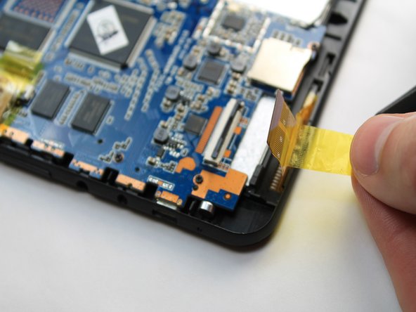

  8. iVIEW-754TPC Logic Board Replacement, Disconnect Digitizer: crwdns2935265:08crwdnd2935265:01crwdnd2935265:03crwdne2935265:0 iVIEW-754TPC Logic Board Replacement, Disconnect Digitizer: crwdns2935265:08crwdnd2935265:02crwdnd2935265:03crwdne2935265:0 iVIEW-754TPC Logic Board Replacement, Disconnect Digitizer: crwdns2935265:08crwdnd2935265:03crwdnd2935265:03crwdne2935265:0
    • Use a spudger to lift the flap on top of the digitizer ZIF socket.
    • Gently pull the tape attached to the ribbon cable to remove the cable from its socket.

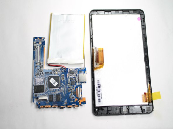

  9. iVIEW-754TPC Logic Board Replacement, Remove Logic Board: crwdns2935265:09crwdnd2935265:01crwdnd2935265:03crwdne2935265:0 iVIEW-754TPC Logic Board Replacement, Remove Logic Board: crwdns2935265:09crwdnd2935265:02crwdnd2935265:03crwdne2935265:0 iVIEW-754TPC Logic Board Replacement, Remove Logic Board: crwdns2935265:09crwdnd2935265:03crwdnd2935265:03crwdne2935265:0
    • Gently slide the spudger below the logic board at the left side nearest the battery. Lift upward and away from the power button and bottom connectors.
    • The battery is still attached to the logic board. Be careful to not tear the two apart during removal.
