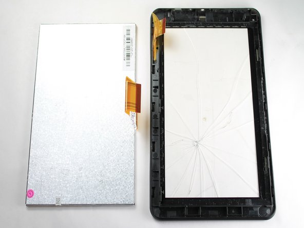

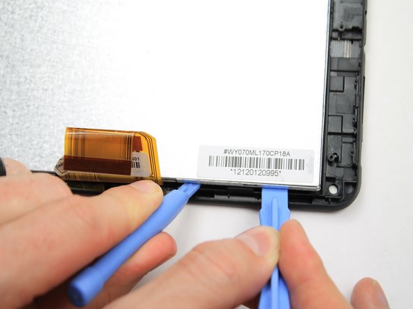

  10. iVIEW-754TPC Digitizer Replacement, LCD: crwdns2935265:010crwdnd2935265:01crwdnd2935265:03crwdne2935265:0 iVIEW-754TPC Digitizer Replacement, LCD: crwdns2935265:010crwdnd2935265:02crwdnd2935265:03crwdne2935265:0 iVIEW-754TPC Digitizer Replacement, LCD: crwdns2935265:010crwdnd2935265:03crwdnd2935265:03crwdne2935265:0
    • Insert a plastic opening tool between the LCD and digitizer on the side of the LCD with the ribbon cable. Use a second plastic opening tool to lift the LCD from the digitizer. Repeat this process on both sides of the LCD ribbon cable.
    • Fully remove the LCD from the digitizer.
