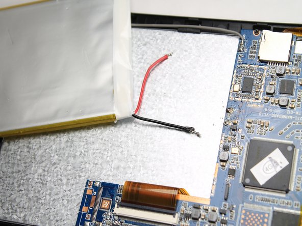

    1. iVIEW-754TPC Battery Replacement, Remove Battery: crwdns2935265:02crwdnd2935265:01crwdnd2935265:03crwdne2935265:0 iVIEW-754TPC Battery Replacement, Remove Battery: crwdns2935265:02crwdnd2935265:02crwdnd2935265:03crwdne2935265:0 iVIEW-754TPC Battery Replacement, Remove Battery: crwdns2935265:02crwdnd2935265:03crwdnd2935265:03crwdne2935265:0
      • Use flat side of the spudger to get under battery and use pressure to release from glue. Do this all the way around battery until it comes off.
      • At this point do not attempt to fully remove the battery as it is still attached to the logic board.

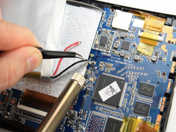

    1. iVIEW-754TPC Battery Replacement, Desolder wires: crwdns2935265:03crwdnd2935265:01crwdnd2935265:03crwdne2935265:0 iVIEW-754TPC Battery Replacement, Desolder wires: crwdns2935265:03crwdnd2935265:02crwdnd2935265:03crwdne2935265:0 iVIEW-754TPC Battery Replacement, Desolder wires: crwdns2935265:03crwdnd2935265:03crwdnd2935265:03crwdne2935265:0
      • Once battery is off, the wires will still be connected to motherboard. You will need to desolder the wires.
      • Using the soldering tool, use the heat to melt the connection. As you do this, pull on the wires with a tweezer until wires comes off.
      • To ease reassembly, take note of which wire goes to the negative and positive terminals.
