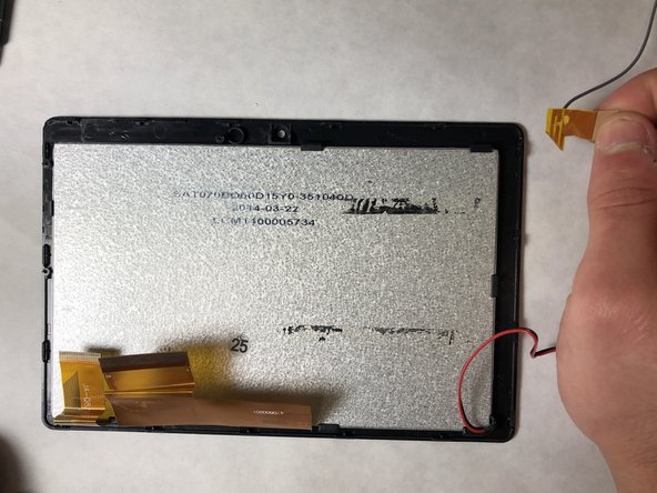

  13. iRulu AX760 Screen Display Replacement, Screen Display: crwdns2935265:013crwdnd2935265:01crwdnd2935265:01crwdne2935265:0
    • Remove the plastic peel attached to the back of the screen display.
  14. iRulu AX760 Screen Display Replacement: crwdns2935265:014crwdnd2935265:01crwdnd2935265:02crwdne2935265:0 iRulu AX760 Screen Display Replacement: crwdns2935265:014crwdnd2935265:02crwdnd2935265:02crwdne2935265:0
    • Remove the grey wire from the back of the screen display.
  15. iRulu AX760 Screen Display Replacement: crwdns2935265:015crwdnd2935265:01crwdnd2935265:01crwdne2935265:0
    • Insert the plastic spudger underneath the screen display and lift.

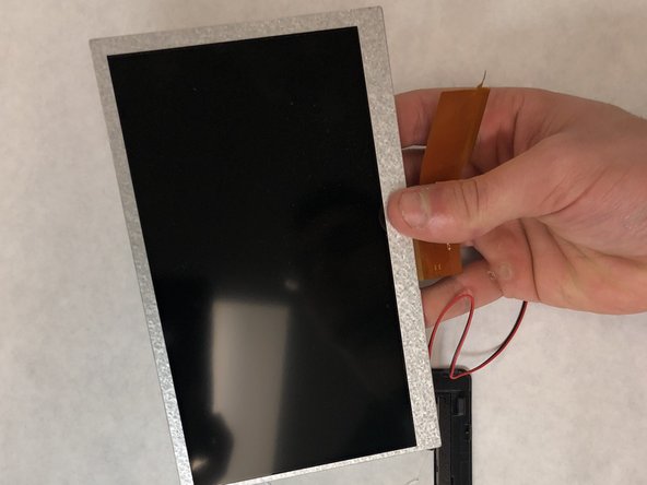

  16. iRulu AX760 Screen Display Replacement: crwdns2935265:016crwdnd2935265:01crwdnd2935265:02crwdne2935265:0 iRulu AX760 Screen Display Replacement: crwdns2935265:016crwdnd2935265:02crwdnd2935265:02crwdne2935265:0
    • Continue lifting the screen by hand and pull it out until it is completely removed.
