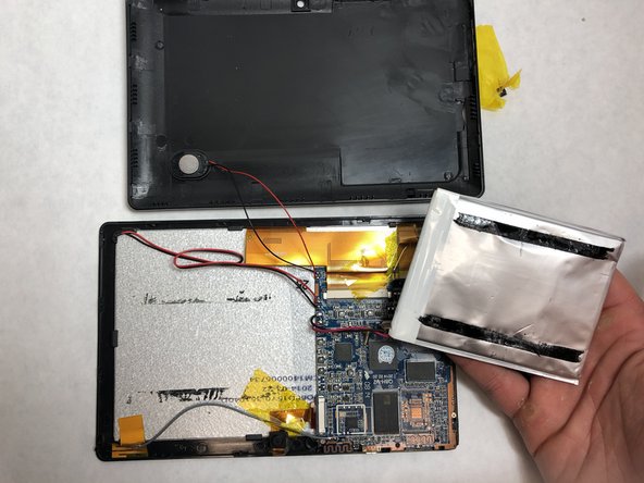

    • Take your plastic flat head tool and insert it under the battery.
    • Lift the battery up.
    • Make sure to remove any tape from the battery.

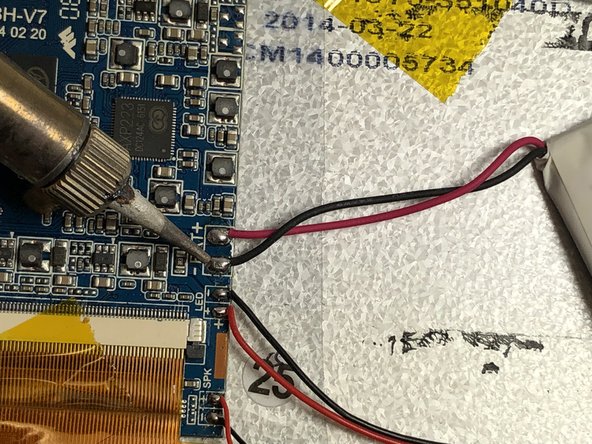

  4. iRulu AX760 Motherboard Replacement: crwdns2935265:04crwdnd2935265:01crwdnd2935265:02crwdne2935265:0 iRulu AX760 Motherboard Replacement: crwdns2935265:04crwdnd2935265:02crwdnd2935265:02crwdne2935265:0
    • Use a soldering iron to remove the solder that connects the black and red wires of the battery to the motherboard.
    • Keep the wires of the battery taught.
    • The iron should only be pressed to the solder for 2-3 seconds max.
    • Be very carful, the soldering iron will be very hot!
    • Visit this link for information about soldering. How To Solder and Desolder Connections

    • Remove your old battery and replace it with the new battery.

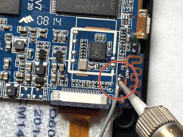

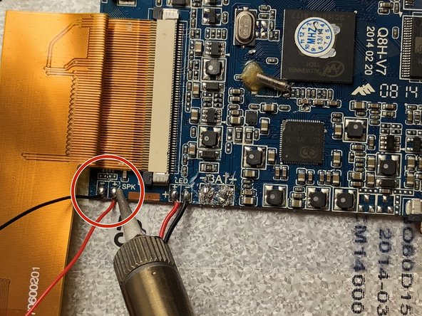

    • WARNING: SOLDERING IRONS BECOME EXTREMELY HOT. DO NOT TOUCH
    • For information on soldering and desoldering, check this link.
    • You must desolder several sets of contacts before attempting to remove the motherboard.
    • You must desolder the BAT (battery), LED, SPK (speaker), and ANT (antenna) contacts.

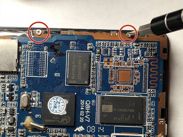

    • Unscrew the motherboard from the screen with the JIS #000 Screwdriver, a Phillips-head type screwdriver

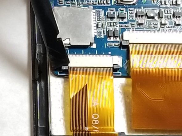

    • Use a plastic spudger to push the tab, releasing the motherboard from the screen. You can now remove the old motherboard.
    • You will not need a metal spudger in order to re-place the motherboard
