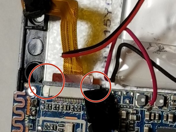

  6. iRulu AX760 Camera Replacement, Camera: crwdns2935265:06crwdnd2935265:01crwdnd2935265:02crwdne2935265:0 iRulu AX760 Camera Replacement, Camera: crwdns2935265:06crwdnd2935265:02crwdnd2935265:02crwdne2935265:0
    • Use the plastic spudger to pry the tabs open on the digitizer ribbon sockets.
  7. iRulu AX760 Camera Replacement: crwdns2935265:07crwdnd2935265:01crwdnd2935265:01crwdne2935265:0
    • Pull the digitizer ribbon cables straight out of their sockets.
  8. iRulu AX760 Camera Replacement: crwdns2935265:08crwdnd2935265:01crwdnd2935265:01crwdne2935265:0
    • Pull the camera out of the device.
