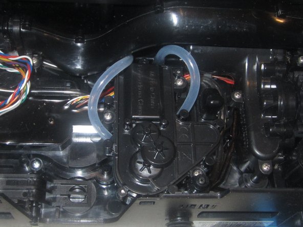

    • This shows the pump removed from the Scooba for Troubleshooting. The two white rings on the inlet and outlet lines at the Scooba are part of the gasket on the pump. The Scooba will now leak when it runs.
    • There are two rollers that "massage" a tube to pump fluid. A roller will pinch the tube and can cause the tube walls to stick and effectively block the pump. People will sometimes try to "prime" the pump by forcing fluid into the Scooba where the tank connects to the Scooba. This can separate one of the ends of the pump. You'll hear a "Pop".

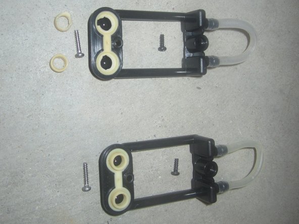

    • Remove these two screws. You can then lift the U-shaped plastic part at the connections where the Tube enters and exits the pump roller and separate the tube from the U-shaped part. Then pull on one end of the pump tube and remove the tube from the pump.

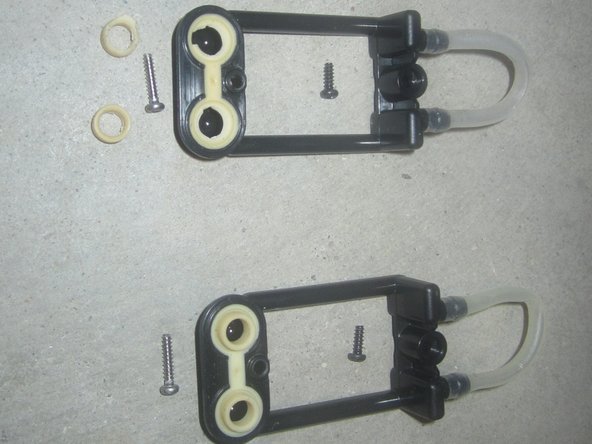

    • Cut a 10 inch or 250mm length of replacement tubing and work it through the pump. It can be done without any dis-assembly. Turn the pump rollers until one is just about to pinch the tube. Push the tube up to the next roller. Keep pushing on the tube and turn the rollers until you can grab the end of the tube and pull it through.
